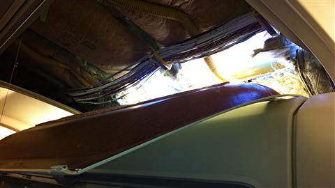

PHOENIX — A Southwest Airlines flight from Phoenix made an emergency landing Friday after a sudden descent and drop in cabin pressure in the Boeing 737 that passengers said was caused by a six-foot-long hole that opened in the top of the plane. Federal officials blamed a "fuselage rupture.."
"It's at the top of the plane, right up above where you store your luggage," passenger Brenda Reese said. "When you look up through the panel, you can see the sky."
