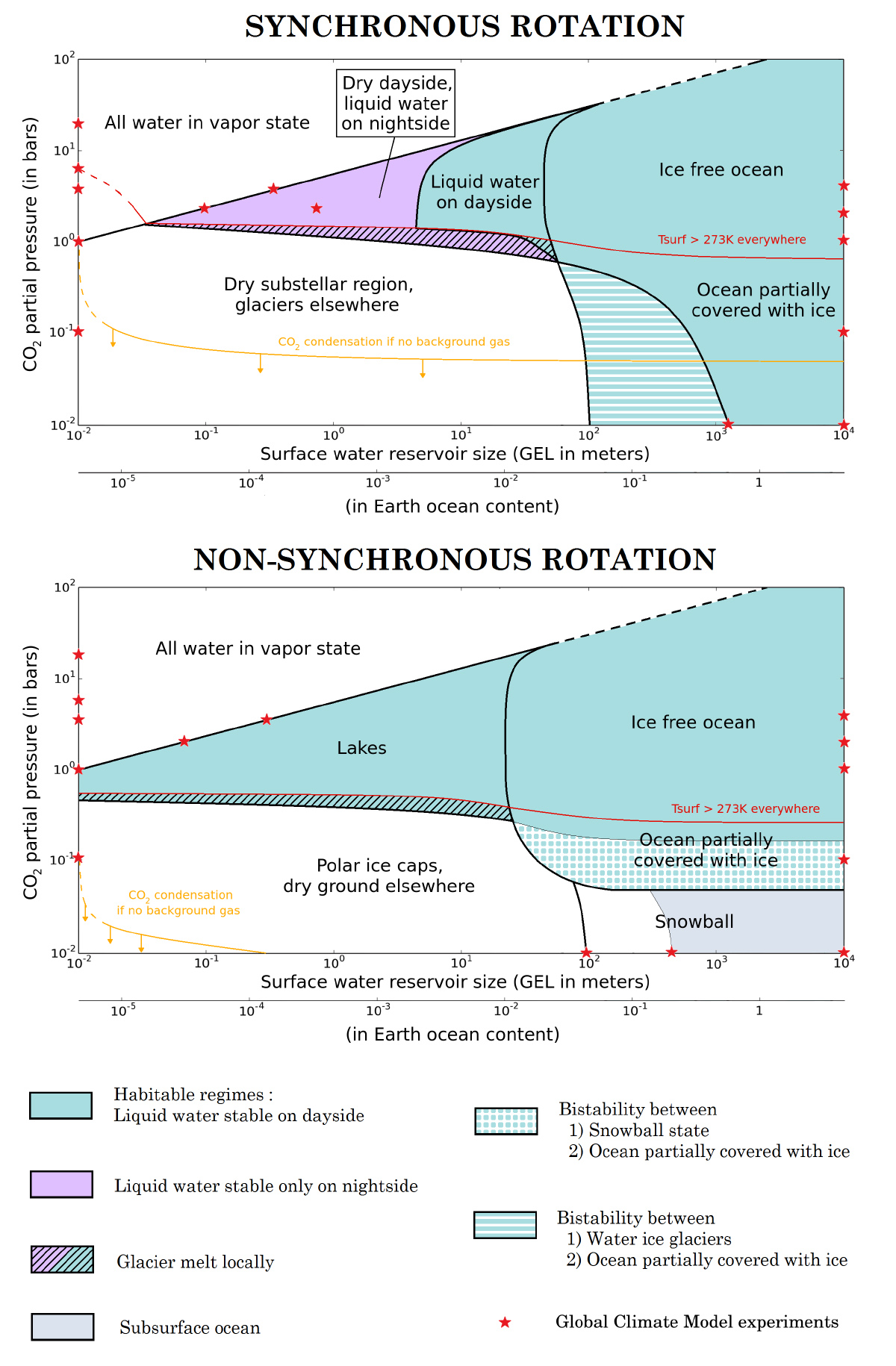

Alexis Posted August 30, 2016 Author Share Posted August 30, 2016 Voici deux articles intéressants qui discutent beaucoup plus en détails l'habitabilité potentielle de Proxima b Habitable Planet Reality Check: Proxima Centauri b Citation Based on the limited data we currently have about Proxima Centauri b, it seems to be potentially habitable, although not very Earth-like. Its MPsini of 1.27 ME suggests that it is a rocky planet instead of a mini-Neptune with little prospect of being habitable in the conventional sense. It is also located inside the habitable zone (HZ) of its host star and detailed 3D global climate models suggest that it could be habitable over a wide range of realistic conditions. Comparing it to other potentially habitable exoplanets currently known (a short list dominated by plants of other rd dwarfs), Proxima Centauri b is probably one of the most promising on par with Kepler 186f. Although this is a hopeful start, we need to avoid getting too wrapped up in the media hype surrounding this important discovery since there is still much that remains to be learned about this new world in the months and years ahead which could affect this assessment. (il vaut la peine de noter que Kepler 186f se situe à... 561 +42/-33 année-lumière de la Terre, c'est-à-dire plus de cent fois plus loin que Proxima b !) Opportunities and Obstacles for Life on Proxima b Citation So is Proxima b habitable? The short answer is “It’s complicated.” Our observations are few, and what we do know allow for a dizzying array of possibilities. Did Proxima b move halfway across the galaxy? Did it endure a planetary-system-wide instability that launched its sibling planets into deep space and changed its orbit? How did it cope with the early high luminosity of its host star? What is it made of? Did it start out as a Neptune-like planet and then become Earth-like? Has it been relentlessly bombarded with flares and coronal mass ejections? Is it tidally heated into an Io-like (or worse) state? These questions are central to unlocking Proxima’s potential habitability and determining if our nearest galactic neighbor is an inhospitable wasteland, an inhabited planet, or a future home for humanity. The last point is not as rhetorical as it might seem. Since all life requires an energy source, it stands to reason that, in the long term — by which I mean the loooong term — planets like Proxima b might be the ideal homes for life. Our Sun will burn out in a mere 4 billion years, but Proxima Centauri will burn for 4 trillion more. Moreover, if a “planet c” exists and slightly perturbs b’s orbit, tidal heating could supply modest energy to b’s interior indefinitely, providing the power to maintain a stable atmosphere. If humanity is to survive beyond the lifetime of our Sun, we must leave our Solar System and travel to the stars. If Proxima b is habitable, then it might be an ideal place to move. Perhaps we have just discovered a future home for humanity! But in order to know for sure, we must make many more observations, run many more computer simulations, and, hopefully, send probes to perform the first direct reconnaissance of an exoplanet. The challenges are huge, but Proxima offers a bounty of possibilities that fills me with wonder. Link to comment Share on other sites More sharing options...
