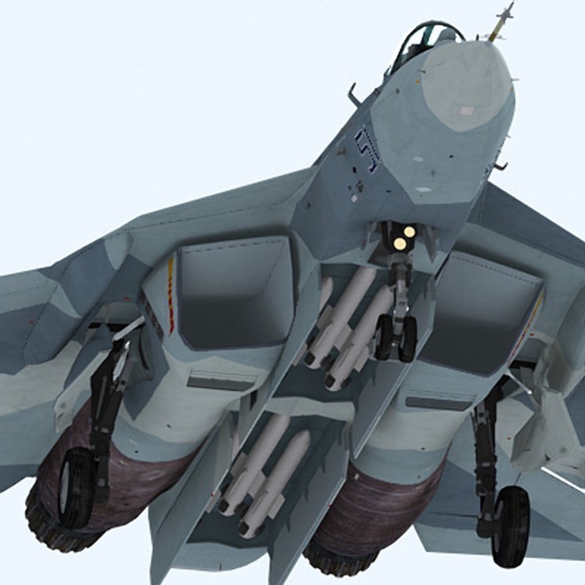

Some of the clues to the fighter's development here also suggest that the T-50 will not constitute the entire fighter force for a long time, if ever. The Tactical Missiles Corporation exhibit booth points to two things: a robust weapons development program for the conventional Su-35S, and a "kick the door down" mission for the stealth fighter.
Absent here is any sign of all-new weapons for the T-50, which instead looks likely to enter service with refined versions of existing systems. Interestingly, the closest that the T-50 (so far) is confirmed to be getting to an all-new weapon is a highly modified version of an existing anti-radar missile, the folding-wing Kh-58UShE.
The Kh-58UShE is very different from earlier versions. It is slightly shorter and has inertial mid-course guidance, and has a broadband seeker where earlier Kh-58s were fitted with different seekers for different targets.
The next likely candidate for the T-50's forward bay is the RVV-BD (air-to-air missile, long range), which is a modernized version of the Vympel R-37 that was designed for the MiG-31M Foxhound-B, but never put into production. Unlike the R-37, it is designed to be carried other than semi-conformal and videos and documents here show it carried by the Su-35S. However, its total external dimensions are within centimeters of the Kh-58UShE. It seems likely, therefore, that the T-50 forward bay has been designed around the minimum-risk RVV-BD, with the Kh-58 being modified to fit the same envelope.
This is all interesting to say the least, because since Day One of stealth in the US a guiding principle has been that stealth gets you close enough to use precise, short-range, low-cost weapons. And here come the Russians, equipping their first stealth fighter -- already fast and high-flying -- with a 1,400-pound ARM that can run out to 245 km at up to Mach 4, and an 1,125-pound, 200-kilometer range AAM.

La faible hauteur des dérives verticales n'est elle pas en partie compensée par le fait qu'elles soient d'un seul bloc ? (Désolé, je ne connais pas le terme exact mais je veut dire que toute la dérive est mobile et non pas une partie comme sur la plupart des avions)
Ces plans canards (je ne sais même pas si c'est le bon terme vu la disposition) sont assez étonnantes.
Je crois que l'on peut parler de LERX mobiles (Leading Edge Root Extension - Extension du Bord d'Attaque à l'Emplanture) ou de LEVCON (Leading Edge Vortex CONtrollers - Surfaces de Controle des Vortex de Bord d'Attaque).
A t'on déjà vu d'autres avions avec ce système ? Quels sont les avantages par rapport à des plans plus classiques ?
On ajoute pas une arête vive de plus a la cellule - ou plutot 2 - , ca limite donc les problèmes de discrétion électromagnétique je suppose.
Je ne connais que le Tejas Naval, pour le moment, avec ce genre de gouverne.
Ceci dit, je ne crois pas que ce type de plan aurait pu voir le jour avant la quasi généralisation des commandes de vol électriques. Et puis les progrès de ces 30 dernières années en calculs de mécanique des fluides et en compréhension des mécanismes de vortex, de décollement de flux et autres contrôle de la turbulence ou de la couche limite sont aussi pour quelque chose dans l'apparition de ces appendices.
