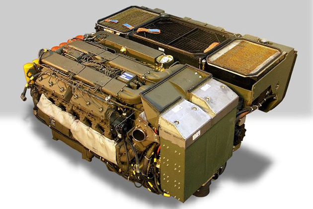

Serge Posté(e) le 18 avril 2016 Auteur Share Posté(e) le 18 avril 2016 (modifié) L'istaelien Nimda se place pour la modernisation des T72 indiens : Citation DefExpo 2016: Nimda offers T-72 upgrade 28th March 2016 - 5:00 by Gordon Arthur in Goa DefExpo 2016: Nimda offers T-72 upgrade Israeli firm Nimda is positioning itself to offer an upgrade for the Indian Army’s ageing Ajeya main battle tanks (MBT), a domestic version of the T-72M1. At DefExpo 2016, the company highlighted its powerpack upgrade capabilities, stating that ‘the company is in the advanced stages of signing an agreement with a local company in order to move production to India’. However, Nimda did not divulge the domestic partner’s name. Isaac Pery, Nimda’s vice president of defence marketing, said, ‘We see India as a strategic market, and will work to promote our solutions on several levels. We will join the Indian company as a business partner in the promotion of tank upgrade projects for the Indian Defence Ministry, and will also cooperate with other local companies that will act as vendors of Powertracks parts.’ Pery added, ‘We are ready to transfer knowhow to India, with all that implies.’ Current engines fitted in the T-72M1 Ajeya offer 780hp of power, but Nimda can boost output to 1,000hp. This is allied with a fully automatic transmission, integral air filtration system and a cooling system suited to extreme environments. The company claims that acceleration times from 0-32km/h can be halved with its powerpack. ‘It substantially increases mobility and manoeuvring capabilities, especially on challenging terrain,’ Nimda said in a press release. Nimda also claimed, ‘The new powerpack provides higher reliability and durability, considerably reducing vehicle downtime. It also enables easier maintenance as well as improved performance in extreme ambient temperatures.’ As well as being a long-time supplier to the Israel Defense Forces (IDF), Nimda highlighted that it has recently completed a similar MBT upgrade programme for a NATO army. Pery promised, ‘We look forward to offering the Indian Army our proven capabilities in this field.’ Nimda has experience upgrading military vehicles of British, French, Russian and US origin. Je m'associerai bien avec Nimda pour mon anti-T90. Ça doit coûter moins cher qu'un moteur allemand. Modifié le 18 avril 2016 par Serge Lien vers le commentaire Partager sur d’autres sites More sharing options...
