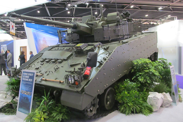

Serge Posté(e) le 17 septembre 2015 Auteur Share Posté(e) le 17 septembre 2015 (modifié) DSEI 2015: UK Warrior CSP builds up 17th September 2015 - 10:14 by Tim Fish in London The first prototype upgraded Warrior infantry fighting vehicle fitted with a new turret has been displayed at the DSEI exhibition in London. The vehicle completed on-the-move firing trials earlier this year and subsequently passed its Critical Design Review (CDR) in May. Rick Edwards, executive VP for Lockheed Martin Missile and Fire Control, told Shephard that the build phase would run until the British Army begins trialling the upgraded Warriors next year. The company is providing turrets for some of the 12 Warrior prototype engineering vehicles that will be tested. Lockheed Martin decided last year that because of problems upgrading the existing turret, they would instead invest in facilities in Ampthill in the UK to completely build a new turret. Although an early variant of the new turret has passed the CDR, Alan Lines, VP and MD of LMUK’s Ampthill site told Shephard there will be a further turret design acceptance after the trials that are due to be completed towards the end of 2017 that will authorise full-scale turret production. ‘An order exists for Warrior, it is just the execution of that,’ he said. The plan is to build 245 turreted Warriors out of a total of 380 upgraded warriors. Babcock is doing the hull work on the chassis, but it is the turret that provides the lethality capability. As the WSCP upgrade contract is fixed-price it means that any changes to the turret that occur within the reliability requirements of the contract will be undertaken by Lockheed Martin UK. If there are changes beyond that scope then there will have to be contractual changes. Edwards said that there was no capability to build large turret structures in the UK and that it was needed in order to control the quality of the product. The company invested £37 million in the Ampthill facility overall and the production line includes two new 5-axis machining units. It is hoped that the MoD will decide to upgrade more than the 245 turrets planned. Edwards said they want to prove the upgrade and get more converted. Lockheed Martin is also contracted to do Assembly, Integration and Testing for turrets for the UK's Ajax armoured reconnaissance vehicle programme (formerly Scout SV). The company are still waiting for news on Kuwaiti plans to upgrade their Warriors under the Desert Warrior programme. Lockheed Martin has a Warrior turret on its stand designed for the export market. Modifié le 17 septembre 2015 par Serge Lien vers le commentaire Partager sur d’autres sites More sharing options...
