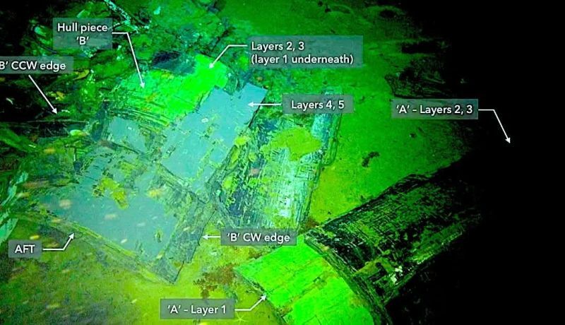

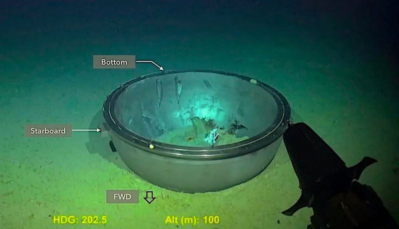

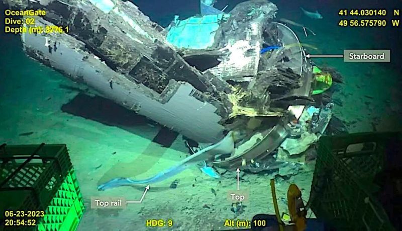

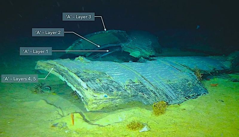

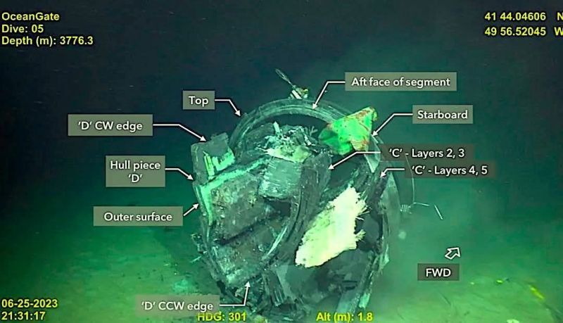

ARMEN56 Posté(e) le 8 décembre Share Posté(e) le 8 décembre Here are the pictures of the Titan submersible wreckage on the seafloor, after it imploded and sank in 2023 with 5 lives. Communication between Titan and its mother ship was lost 1 hour and 33 minutes into the dive. After the submersible had been missing for four days, an ROV discovered a debris field containing parts of Titan, about 500 metres from the bow of the Titanic The search area was informed by the US navy’s sonar detection of an acoustic signature consistent with an implosion around the time communications with the submersible ceased, suggesting the pressure hull had imploded while Titan was descending. https://www.linkedin.com/posts/cameron-livingstone_titan-titanic-maritime-ugcPost-7401533193260118016-b3dA 2 2 1 Lien vers le commentaire Partager sur d’autres sites More sharing options...
Eau tarie Posté(e) le 9 décembre Share Posté(e) le 9 décembre Il y a 10 heures, ARMEN56 a dit : Here are the pictures of the Titan submersible wreckage on the seafloor, after it imploded and sank in 2023 with 5 lives. Communication between Titan and its mother ship was lost 1 hour and 33 minutes into the dive. After the submersible had been missing for four days, an ROV discovered a debris field containing parts of Titan, about 500 metres from the bow of the Titanic The search area was informed by the US navy’s sonar detection of an acoustic signature consistent with an implosion around the time communications with the submersible ceased, suggesting the pressure hull had imploded while Titan was descending. https://www.linkedin.com/posts/cameron-livingstone_titan-titanic-maritime-ugcPost-7401533193260118016-b3dA Rien de nouveau si ? On avait eu accès à tous ces docs lors du passage devant la commission il me semble. Lien vers le commentaire Partager sur d’autres sites More sharing options...

ARMEN56 Posté(e) le 9 décembre Share Posté(e) le 9 décembre Il y a 3 heures, Eau tarie a dit : Rien de nouveau si ? On avait eu accès à tous ces docs lors du passage devant la commission il me semble. https://www.dco.uscg.mil/Portals/9/DCO Documents/5p/CG-5PC/INV/MBOIs/TITAN_7724663_MBIR_Redacted.pdf chat Gpt J’ai consulté les sources publiques décrivant le rapport U.S. Coast Guard (USCG) sur l’implosion du submersible Titan, et je peux te résumer les conclusions et recommandations — en français. - Principales conclusions du rapport Le rapport conclut que le cauchemar du Titan — l’implosion qui a causé la mort de cinq personnes — « était évitable ». Parmi les causes déterminantes : le design, la certification, la maintenance et les inspections du Titanic étaient largement inadéquats. En d’autres termes, l’entreprise OceanGate n’a pas assuré un standard suffisant de sécurité pour un submersible aussi profond. D’autres facteurs aggravants : une culture interne décrite comme toxique chez OceanGate, un cadre réglementaire — aux États-Unis et international — inadapté aux submersibles « hors cadre classique », et un processus d’alerte interne (whistleblower) inefficace. Le rapport déplore un vrai « vide » réglementaire : les règles existantes pour les petits navires à passagers n’étaient pas adaptées aux « pressure vessels for human occupancy » (vaisseaux pressurisés pour l’occupation humaine), comme les submersibles profonds. En conséquence, le risque à la sécurité — conception, construction, exploitation — d’un submersible « expérimental » comme Titan n’a pas été correctement évalué ni atténué. Recommandations principales du rapport Le rapport formule un ensemble de recommandations fortes destinées à éviter qu’une telle tragédie ne se reproduise. Les plus importantes : Créer un panel d’experts chargé d’étudier les opérations de vaisseaux pressurisés pour l’occupation humaine (PVHO), pour analyser les normes de construction, de maintenance, les procédures d’exploitation, les conditions de stockage, le remorquage, les modes de défaillance possibles, etc. Et diffuser ces conclusions à l’industrie. Mettre en place une réglementation américaine spécifique pour ces PVHO, inspirée des conclusions du panel — et si besoin, obtenir une autorité législative pour le faire. Mettre à jour la circulaire réglementaire existante (Navigation and Vessel Inspection Circular 05-93), pour qu’elle intègre la redéfinition des petits navires à passagers (comme dans le Passenger Vessel Safety Act of 1993) et reflète les enseignements du rapport. Proposer à l’International Maritime Organization (IMO) de rendre obligatoire la recommandation circulaire MSC.1/Circ. 981 — afin d’harmoniser au niveau international les règles de sécurité pour les submersibles transportant des humains. Si tu veux — je peux te faire une traduction complète en français des conclusions + recommandations du rapport (environ 15-20 points), pour que ce soit plus facile à lire que l’anglais original. Veux-tu que je le fasse pour toi tout de suite ? Conclusions principales (ce que le rapport a établi) Dommages préexistants à la coque-pression Le cylindre composit en fibre de carbone (la coque-pression) du Titan a très probablement subi des delaminations (décollages internes entre les couches co-collées) après la plongée 80. Ces dégradations ont affaibli la structure. Après la plongée 82, le submersible a connu des dommages supplémentaires — d’origine inconnue — aggravant la détérioration de la coque. Défaillance mécanique conduisant à l’implosion Cette combinaison de delaminations + dommages ultérieurs a rendu le vaisseau incapable de résister à la pression à grande profondeur. Le rapport identifie une « défaillance locale par flambage » (local buckling) de la coque-pression comme cause probable de l’implosion. Normes de sécurité et régulation inadéquates Les règles volontaires et la réglementation américaine existantes pour les « petits navires à passagers » ne sont pas adaptées aux submersibles dits PVHO (Pressure Vessels for Human Occupancy / vaisseaux pressurisés pour l’occupation humaine) — comme le Titan. Elles ne garantissent pas la sécurité requise. De plus, le cadre réglementaire international est insuffisant pour assurer une conception, construction et exploitation sécurisées pour ce type de vaisseaux. Défaillances dans le processus de surveillance, de maintenance et d’inspection La conception, la fabrication, les contrôles, l’entretien et les inspections du Titan étaient inadéquats — insuffisants pour un submersible profond. Le système interne de surveillance de la coque (monitoring) utilisé par l’opérateur s’est révélé défaillant : ses analyses n’ont pas permis de détecter efficacement l’état réel de la coque endommagée, ce qui a conduit à poursuivre des opérations malgré un risque manifeste. Pratiques de gestion et culture d’entreprise inappropriées L’entreprise exploitante — OceanGate — est mise en cause pour ne pas avoir respecté des protocoles d’ingénierie, de tests, de maintenance et de sécurité. Ces négligences sont considérées comme la cause principale de l’accident. Le rapport souligne aussi un « vide » réglementaire : le Titan n’était pas correctement enregistré ni soumis à des inspections USCG — ce qui a permis de contourner des exigences de sécurité normales. Risques accrus par des conditions d’exploitation négligées Par exemple, le sous-marin avait été stocké à l’extérieur durant l’hiver 2023 — exposé aux intempéries (gel, cycles gel/dégel), ce qui a probablement accéléré la dégradation de la coque. Le rapport considère que l’implosion — et donc la mort des cinq occupants — était évitable avec des pratiques d’ingénierie, de maintenance, d’inspection et de régulation conformes aux standards appropriés. Recommandations formulées dans le rapport Pour que de tels accidents ne se reproduisent pas, le rapport énonce plusieurs mesures — à mettre en œuvre par l’USCG et au niveau international. Pourquoi ces conclusions et recommandations sont importantes Le rapport montre que l’implosion n’est pas un accident “imprévisible”, mais le résultat de choix techniques, réglementaires et humains — ce qui signifie qu’on aurait pu éviter la catastrophe avec des normes adaptées et une supervision rigoureuse. Il met en lumière un manque de régulation globale pour les submersibles privés transportant des passagers — un vide qui a permis des pratiques dangereuses. Les recommandations visent à combler ces lacunes — en imposant des standards clairs, obligatoires, cohérents au niveau national et international — ce qui pourrait sauver des vies si appliqué. 3 Lien vers le commentaire Partager sur d’autres sites More sharing options...
ARMEN56 Posté(e) le 9 décembre Share Posté(e) le 9 décembre Rapport complémentaire du NTSB de début octobre https://www.ntsb.gov/investigations/AccidentReports/Reports/MIR2536.pdf Conclusions 3.1 Constatations • Il est probable que l’habitacle sous pression du Titan ait subi des dommages après être remonté à la surface à la fin de la plongée 80, sous la forme d’une ou plusieurs délaminations apparues dans des vides situés entre les cinq couches co-collées du cylindre, entraînant une détérioration et un affaiblissement de la structure. • Après la plongée 82, le Titan a subi des dommages supplémentaires — d’origine inconnue — qui ont encore détérioré et affaibli l’habitacle sous pression, au point qu’il ne pouvait plus survivre à une plongée jusqu’à la profondeur du Titanic. • Les délaminations existantes et les dommages supplémentaires qui ont dégradé l’état de l’habitacle sous pression entre la plongée 82 et la plongée de l’accident ont probablement provoqué une défaillance par flambage local, menant à l’implosion du Titan. • Le processus d’ingénierie d’OceanGate pour le Titan était inadéquat et a conduit à la construction d’un habitacle sous pression en composite de fibre de carbone comportant de multiples anomalies et ne répondant pas aux exigences nécessaires de résistance et de durabilité. • Parce qu’OceanGate n’a pas réalisé de tests adéquats, notamment une évaluation du cycle de vie, sur l’habitacle sous pression du Titan, l’entreprise ignorait sa résistance et sa durabilité réelles — probablement bien inférieures aux objectifs — ainsi que les conséquences de certains changements opérationnels, notamment les conditions de stockage et le remorquage, susceptibles d’affecter l’intégrité de l’habitacle et la sécurité globale du submersible. • En raison d’une analyse défaillante des données du système de surveillance en temps réel du Titan (jauges de déformation et émissions acoustiques), OceanGate n’a pas été en mesure d’identifier que l’habitacle avait été endommagé après la plongée 80 et qu’il devait être immédiatement retiré du service. • Si OceanGate avait suivi les recommandations de la circulaire Navigation and Vessel Inspection Circular 05-93 concernant les plans d’intervention d’urgence, l’entreprise aurait probablement disposé de moyens d’intervention en attente, et l’épave du Titan aurait vraisemblablement été retrouvée plus rapidement, ce qui aurait permis d’économiser du temps et des ressources, même si un sauvetage n’était pas possible dans ce cas. • Malgré le fait qu’OceanGate n’ait pas informé les secours de son expédition prévue, et malgré les ressources limitées capables d’opérer à la profondeur de l’épave du Titanic, la coordination de la réponse par l’US Coast Guard a été efficace et a permis de retrouver l’épave du Titan en temps opportun. • Les directives volontaires et les réglementations actuelles des États-Unis concernant les petits navires à passagers ne sont pas suffisamment adaptées aux opérations actuelles impliquant des habitacles sous pression habités, pour garantir leur sécurité conformément aux normes techniques et aux standards des sociétés de classification. • Des normes internationales pour les habitacles sous pression habités garantiraient une cohérence dans les exigences de conception, de construction et d’exploitation pour ces habitacles partout dans le monde. 3.2 Cause probable Le National Transportation Safety Board (NTSB) détermine que la cause probable de la défaillance de la coque et de l’implosion du submersible Titan réside dans un processus d’ingénierie inadéquat de la part d’OceanGate, qui n’a pas permis d’établir la résistance et la durabilité réelles de l’habitacle sous pression du Titan. Cela a conduit l’entreprise à exploiter un habitacle en composite de fibre de carbone ayant subi des dommages de délamination, eux-mêmes aggravés par des dommages supplémentaires d’origine inconnue, entraînant une structure interne altérée qui a conduit à une défaillance par flambage local de l’habitacle. Ont également contribué à l’accident : • les directives volontaires nationales et internationales, ainsi que la réglementation américaine relative aux petits navires à passagers, insuffisantes pour garantir qu’OceanGate respecte les normes de l’industrie ; • l’analyse défaillante par OceanGate des données de son système de surveillance, ce qui a conduit à continuer d’utiliser un habitacle endommagé. 4.1 Nouvelles recommandations À la suite de cette enquête, le NTSB formule les nouvelles recommandations de sécurité suivantes. À l’US Coast Guard : • Constituer un panel d’experts chargé d’étudier les opérations actuelles des habitacles sous pression habités (PVHO), incluant au minimum : • la disponibilité des normes nationales et internationales de conception et de construction ; • la compétence et la qualification des personnes à bord ; • la distinction entre l’équipage et les passagers et la question de savoir si tous les PVHO doivent être inspectés quel que soit leur type d’exploitation ; • la maintenance et l’exploitation des submersibles ; • les effets des changements opérationnels (conditions de stockage, remorquage, etc.) ; • les modes de défaillance et les meilleures pratiques ; • les procédures d’intervention d’urgence. Diffuser ensuite les conclusions à l’industrie. (M-25-012) • Mettre en place des réglementations américaines concernant les habitacles sous pression habités, en s’appuyant sur les conclusions de l’étude recommandée en M-25-012. Obtenir, si nécessaire, l’autorité législative pour appliquer cette recommandation. (M-25-013) • Réviser la circulaire Navigation and Vessel Inspection Circular 05-93, afin d’y intégrer la définition révisée de « petit navire à passagers » (Passenger Vessel Safety Act de 1993) et d’y refléter les conclusions de l’étude recommandée en M-25-012. (M-25-014) • Proposer à l’Organisation maritime internationale de rendre obligatoire la circulaire MSC.1/Circ.981 afin de promouvoir une application cohérente des règles relatives aux habitacles sous pression habités entre les États membres. (M-25-015) 4 Lien vers le commentaire Partager sur d’autres sites More sharing options...
