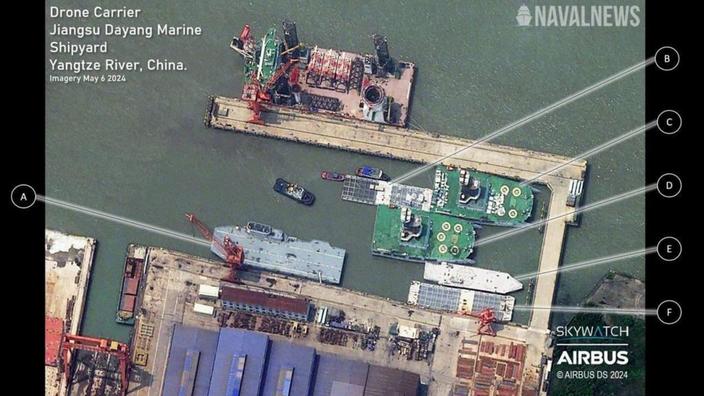

Quand la réalité rejoint la fiction.
https://www.lefigaro.fr/international/un-journaliste-americain-decouvre-sur-une-image-satellite-un-inedit-porte-drones-chinois-20240518
https://www.navalnews.com/naval-news/2024/05/china-builds-worlds-first-dedicated-drone-carrier/
La Chine semble travailler sur un pont plat destiné à employer des drones.
Le bâtiment mesurerait 100 mètres de long pour 30 de large. Ce serait un catamaran et il n'aurait pas de hangar.

... Voilà la version de 15000 tonnes Chinoise -->
  Some time ago someone posted the contract requirements, which thanks to google translate led to this summary by past me:
This is a 15,000 ton (design displacement), 200 meter long ship with a 38.8 meter beam. The ship was described as a test platform intended for special missions, marine survey, and scientific research, and is expected to be a UAV carrier for UAV experimentation/trials (rather than using other ships that can instead focus on operational missions) and limited combat missions. She’s being built at a shipyard that typically builds auxiliaries, not proper warships, and combined with these photos the very limited combat capability is apparent. The through-length flight deck is 25 meters wide, and the contract calls for a hangar and well deck in the stern. The required performance was a speed of 16 knots, a range of 5,000 nautical miles at not less than 12 knots, and an endurance of 40 days (stores rather than fuel).
Des images du dernier né en Chine
clearest-photos-yet-of-the-new-chinese-r
