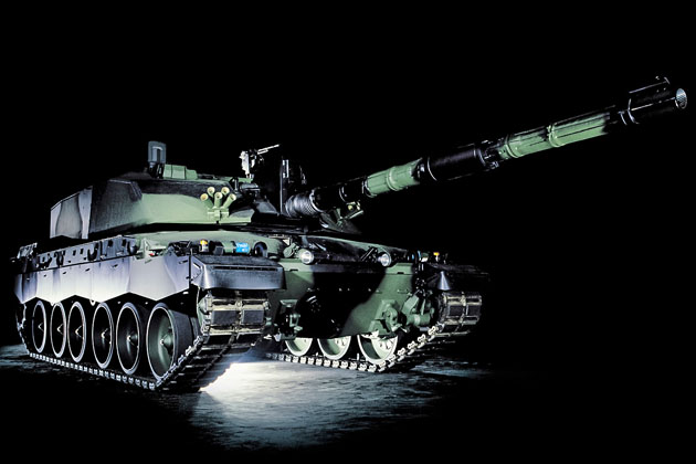

Final bids in for Challenger 2 LEP
Nicholas de Larrinaga, London - IHS Jane's Defence Weekly
11 August 2016
Final bids for the British Army's Challenger 2 main battle tank (MBT) upgrade programme were submitted by industry on 11 August.
The life extension programme (LEP) for the Challenger 2 aims to keep 227 of the MBTs in service until 2035 and will see the replacement of most of the tanks electronics, including its sighting systems. The LEP, however, does not envisage a major upgrade of the vehicle's drive systems or replacement of the MBT's 120 mm L30A1 rifled gun.
Five bidders are known to have pitched for the LEP programme, which is valued at around GBP250 million (USD325 million).
(100 of 469 words)
Modifié par Serge
Analysis: Challenger 2 - the bids are in
16th August 2016 - 12:00 by Tim Fish in London
Given the lack of armoured vehicle manufacturing capability in the UK, domestic contenders for the Life Extension Project (LEP) for the British Challenger 2 MBT are being forced to draw on overseas experience to bid on the programme.
The LEP is now gathering pace with five team bids for the assessment phase having been received by the UK MoD.
London will narrow the contenders down to two and while a decision was expected on 1 September 2016, it is now expected towards the end of the year.
BAE Systems and GDLS were first to bid, with CMI Defence and Ricardo UK announcing their interest at Eurosatory. Lockheed Martin UK and Elbit Systems went public on 10 August while Rheinmetall announced its partnership with Supacat, Thales UK and BMT just before the 11 August deadline along with RUAG Defence.
The two that are selected for the assessment phase will each get contracts worth £19 million. This phase will last two years until end of 2018, when a demonstration, manufacture and in-service support contract will be awarded to the winning team.
The UK MoD still plans to modernise 227 Challenger 2 tanks. (Photo: UK MoD)
The only company with any recent work experience on Challenger 2 is Babcock DSG, which has taken over the UK MoD’s maintenance and support work at Bovington and the company will have a role whichever team wins.
The invitation to negotiate (ITN) for the assessment phase contract requires industry contenders to consider any support options for new equipment they want to provide ‘in conjunction with’ the primary support provider and that bidders ‘will be expected to demonstrate a willingness and capability to work with Babcock DSG’.
The original manufacturer of the Challenger 2 was BAE Systems, but it has no recent experience on the platform or upgrading MBTs. The company is not an automatic shoe-in and needs to draw on GDLS, which does work on M1 Abrams MBTs.
BAE does have a reference collection of vehicles the company once built at its facility in Telford, which it uses for developing upgrades, new variants and training. But it has stated that Challenger 2 conversion work on what it is calling 'Mark 2' standard will be done at the facility of GDUK in Wales.
The option facing Lockheed Martin UK and Elbit Systems is similar. LMUK has not had experience upgrading MBTs, hence their partnership with Elbit. But much of the LEP work is turret related and LMUK has an advantage here as it has a turret manufacturing capability at its facility in Ampthill where working on the Warrior IFV upgrade and Ajax programmes. It could do Challenger 2 LEP work there or at Bovington.
Turret_manufacturing-LMUK-Ampthill-site.
Turrets rolling off the production line at Ampthill. (Photo: LMUK)
According to Richard Muir, business development director at LMUK the LEP assessment phase ‘aligns very well with WCSP and the Ajax’ because as those existing programmes move into production it will be ‘low risk’ to roll the R&D resources off them and over to Challenger 2.
The Ajax and Warrior programmes run out to 2022-23 so there is some longevity at the Ampthill site and they are looking to the next big programme.
One minor concern is Oman, which with 38 Challenger 2 tanks has observer status on the LEP. Would the country be happy with a team including Elbit doing work on their tanks using transfer of technology from Israel?
However, Muir insisted that Lockheed Martin UK and Elbit Systems UK were British entities despite the ability to draw back to their parent companies.
LMUK's bid also relies on Elbit's experience upgrading M60, Merkava and T-72 tanks. (Photo: LMUK)
Can life extension become an upgrade?
A lethality enhancement study will be conducted as part of the assessment phase and the teams can offer new technologies. But Muir warned that ‘whatever comes out has to be cost effective and compatible with the customer requirements’.
LMUK is considering incorporating an anti-tank guided weapon and target designator to allow a joint fires capability. The UK MoD is also expected to decide on a soft-kill defensive aid suite in 2017 that could be included.
However the MoD’s plan to buy an interim thermal imaging unit for Challenger 2 has pretty much died. According to industry, the plan now is to wait for the solution in the LEP.
Replacing the gun could offer a significant capability, but cost is an issue. (Photo: UK MoD)
While there is no requirement to replace the 120mm rifled L30 gun, that has not stopped industry from looking at the issue and if they can offer it within the £642 million budget.
Rheinmetall supplied the L/55 smoothbore 120mm gun in a technical demonstrator programme under a BAE-led upgrade proposal for Challenger 2 back in 2003-06, but no money was available then either. Installing a new gun means new optics, fire control system and re-designed ammo storage, hence the large cost associated with it.
Nevertheless, it makes sense for Rheinmetall to make the offer anyway. If the British Army cuts its Challenger 2 regiments from three to two, it means fewer tanks getting the LEP, which could free up funds, although still not enough for a gun replacement.
The company has plenty of direct in-depth experience upgrading Leopard 2 MBTs so understands the complexities of such a programme over some other competitors.
Rheinmetall certainly needs the work - with German rival KMW taking the domestic Leopard 2 upgrade work it has left Rheinmetall to fight for export projects.
Lethality options are on the table. Can industry make an offer UK MoD can't refuse? (Photo: UK MoD)
Outside of lethality there are questions about mobility and protection. The Team Challenger leaflet makes no mention of a replacement powerpack or armour, and only mentions an 'opportunity for future capability improvements' - which implies more money - although the MoD is looking at APS for all armoured vehicles in a separate project.
Modifié par Serge
Petit détail.
Les britanniques ont produit plus de 400 Challenger-2. Ce char n'a structurellement presque pas bougé depuis sa mise en production. Ils en ont 227 en service.
Cela signifie qu'ils ont un stock particulièrement important de chars. Ils peuvent donc gérer une attrition importante mais aussi décliner des versions spécialisées.
Un Challenger T40, pourquoi pas.
